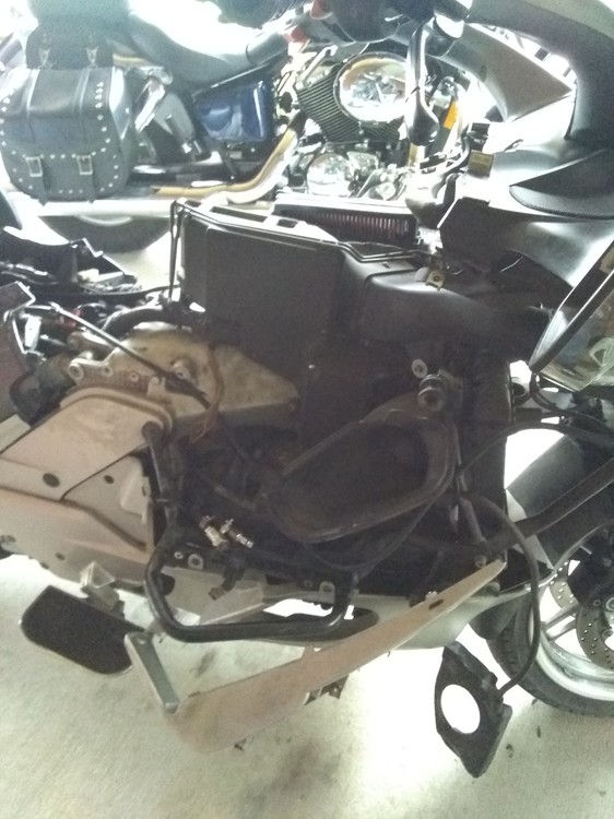

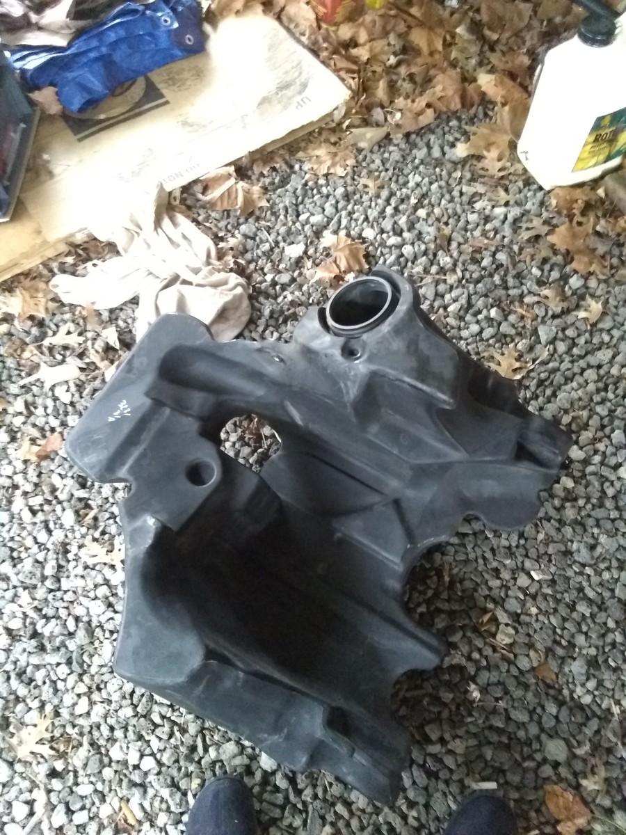

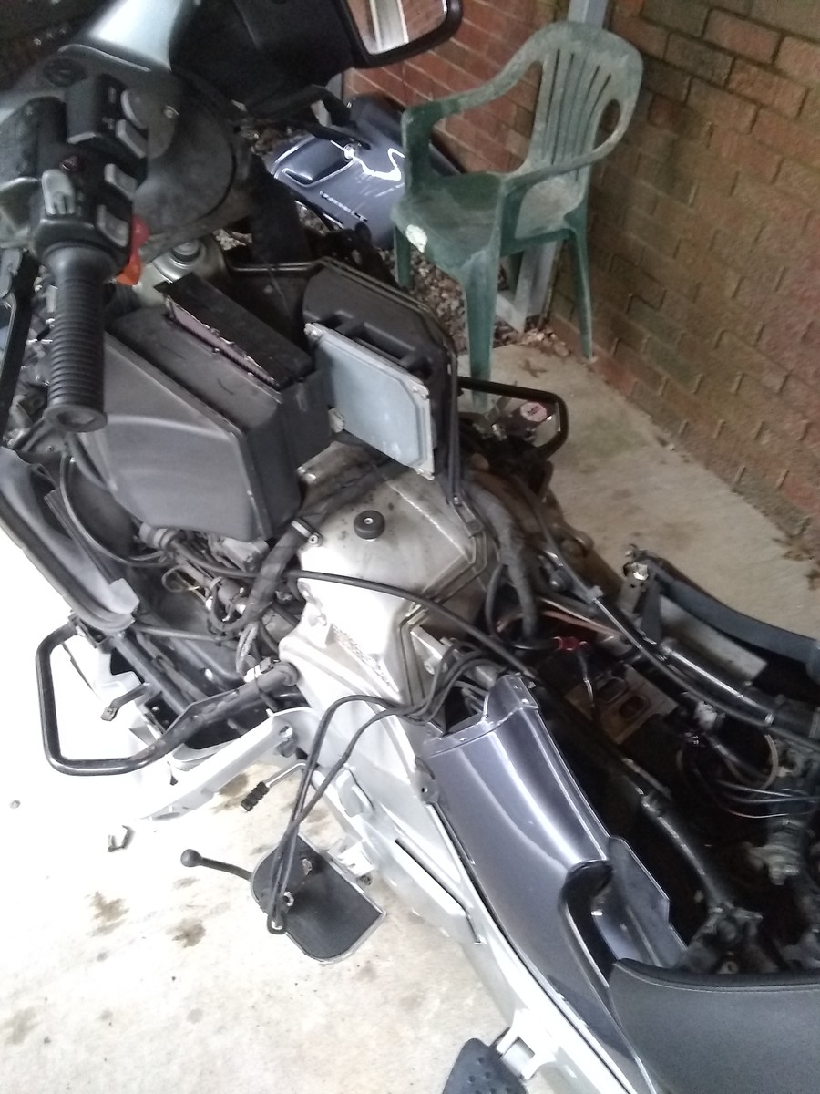

Super Sabre Posted March 21, 2020 Author Posted March 21, 2020 Ok got her all apart, It needed new fuel tank seal. I'm changing seal, fuel filter , tank hoses and servicing air filter. I am going also to try the ABS reset and will let everyone know how it goes. Also installed Stainless Steel quick Connects. 1
