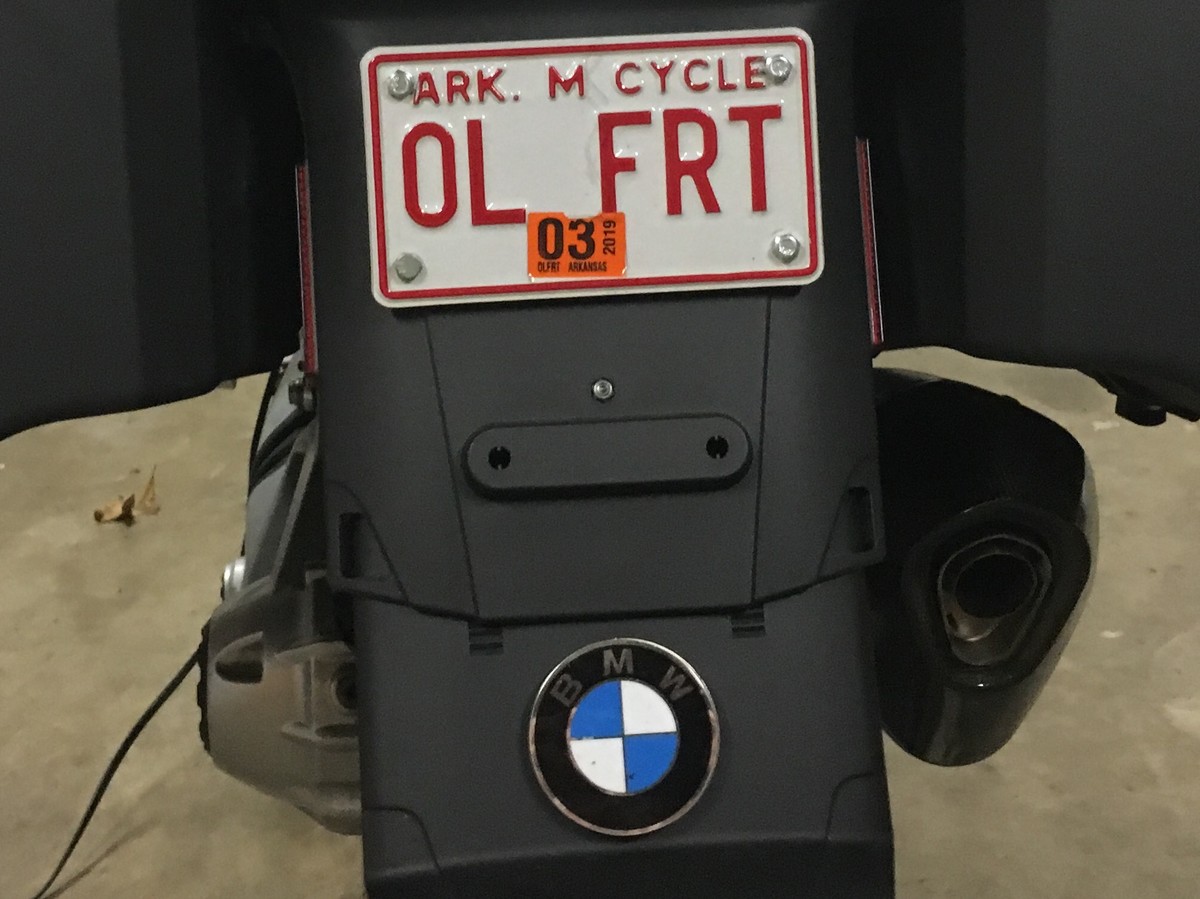

5 hours ago, wbw6cos said:
Old fort?
Front?
That would be old fart
A guy named GARS over on the k1600forum.com makes these black metal plates to cover that area up.  He supplies 2 bolts too.  It typically ships with 2 holes in them.  You're supposed to buy a 58mm roundel, I forget from which older bike.  Instead, I ordered mine with no holes and bought some cheaper metal stickers.  I think the BMW roundel was $60-70 range.  Instead, I bought a piece on EBay that is same diameter that is supposed to go in as a center cap to a BMW auto rim.  The ones I bought had a slight bubble to them that I didn't know about.  But I was able to press them flat when installing.  It ended up being a couple of mm's larger than the plate.  So my sticker hangs over the edge slight.  But if you don't bang that edge with something heavy, you'll never know.
I think it was around $20 for GARS plate.  Very heavy plate BTW.  Then another $16 for the metal sticker.  I put one on both my bike and the wife's.  It does it's job covering that area.  And I didn't spend any more than I had to.
