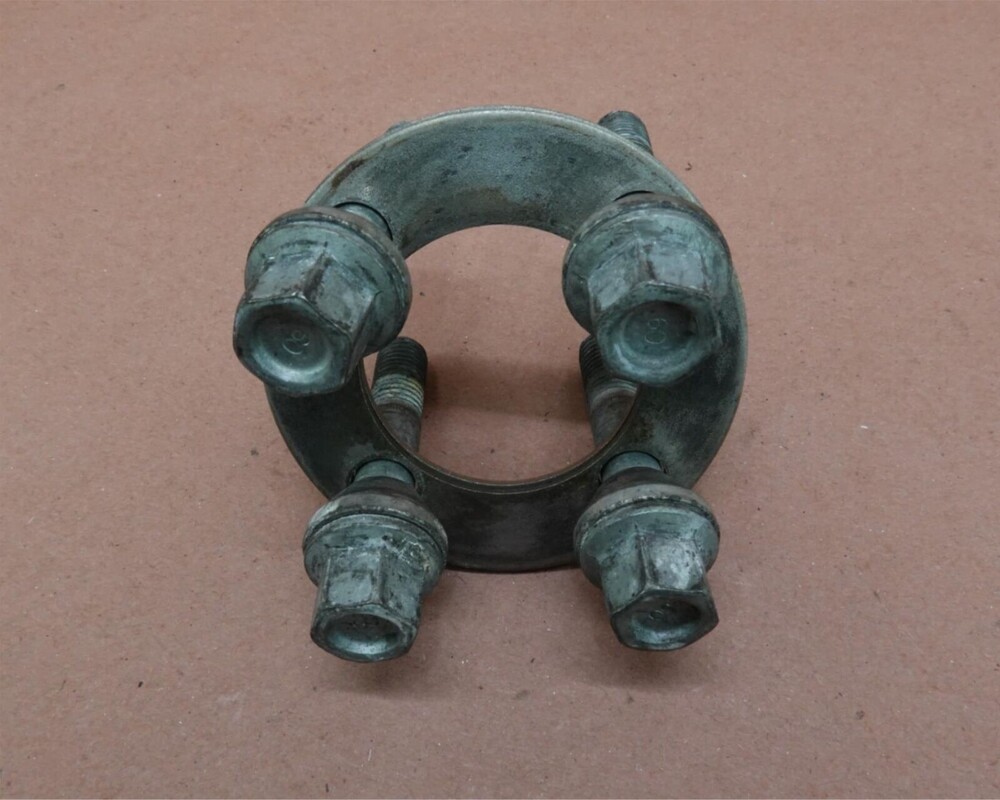

I found this on eBay for $17:
That will give me from zero to six millimeters of offset to play with.  It's unfortunate that this will be such a long-term study.  Looks like I'm going to have to do a lot of riding this Spring.  Oh, woe is me...!  :4322:

Having found the Pirelli, the Metzeler is actually the second tire, but I hadn't posted that before you wrote (thank you for your input!).  Always a good idea to create neutral handling in a motorcycle, but now we seem to have evidence that the left side tire wear was worse when the shim was removed.  I'm being careful about drawing conclusions here because we have a different tire and a different rider, so again, not much of a controlled study.
Since I can see that the Pirelli had some (but seemingly less) left side wear with one 2mm shim,  I am thinking that my next experiment will be 2 shims (4mm) to try to create a better wheel alignment, and then use weight on the left side of the bike to bring it into balance.  I've put 12 pounds into the accessory box (radio box?) and I'll try adding 5 lb ankle weights in the left saddlebag until the bike stays straight when I let go on the highway.  The downside to this is that adding 25 pounds or more of additional mass to any motorcycle is definitely not a performance recipe.

Afternoon Nexus9
2 shims might not be a good thing as that not only decreases your lug bolt engagement but that gives more places for slippage between the shims so you could end up with your wheel coming loose.  In my day job I have tested a number automobiles with shimmed wheels for one reason or another & 2 or 3 wheel shims has given us a lot of wheel loosening issues.
If you want a thicker shim  then make a one-piece thicker shim but I can't understand why you would ever want to move your wheel more to the left as that is definitely the wrong direction as your motorcycle is already heavier right of center so moving the rear wheel left will just make that condition worse.
