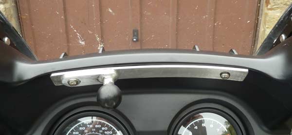

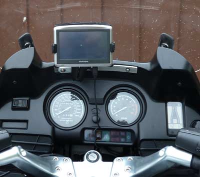

Phil50 Posted May 7, 2011 Share Posted May 7, 2011 I've been fancying one of those Ram mounts that Migsel make. I've always been too mean and made do with a RAM-B-252U pinched onto one of my handlebar studs with a bit of tube and homemade rubber gasket (to stop it rubbing). I found a length of 20mm x 3mm stainless steel in the garage and decided to use this to make myself a mount to sit under the wind shield. The Ram (RAM-B-252U) fitting is stuck to the steel using a mixture of epoxy and microfibres (I have a boat so have this stuff to hand). I sanded the steel and the base of the Ram fitting on a belt sander to clean it up and create a really good key. I just bent it by hand untill it fitted perfectly. I'd previously drilled 3 holes in the stainless, 2 are obvious the other is to form a peg into the base of the ball which already had a recess that a cleaned out. I'm not sure this was necessary but it seemed like a good idea at the time. I painted it with special metals primer and Hamerite flat finish paint but made a "pigs ear" of the paint job so ended up sanding the whole thing off. I'll put some clear lacquer on when I'm feeling in the mood. Anyway here are some pics. If I'd had to buy everything the steel would have cost $2 the fitting $13 and who knows what the epoxy and microfibre would have cost. I'm posting this here in case it provides an idea for other members. Link to comment

Phil50 Posted May 7, 2011 Author Share Posted May 7, 2011 I had my satnav mounted on the handlebar for 3 years and it was OK. Simply shifting it to the new position under the wind shield puts it in the perfect position. The point is for you guys with the handlebar mounts if you have 8 inches of 20mm x 3mm stainless or aluminium and some epoxy you can make your handlebar mount into one that puts your satnav into the perfect position. -- I wish I'd washed the bugs off my wind shield before I took that pic. Link to comment
Ian Posted May 8, 2011 Share Posted May 8, 2011 Phil, Why did you offset the mount to the left? Ian Link to comment

Phil50 Posted May 8, 2011 Author Share Posted May 8, 2011 Why did you offset the mount to the left? Hi Ian, It goes either way but to the left seemed natural to me for some reason. I was thinking that if I ever needed to mount another gadget I could put another at the other side. If you mean why didn't I put it in the middle, it is simply because I wanted to put a screw/stud through the fitting and it was easier to have it at one end. That is rather than have to either use a countersunk fixing or stand the assembly the thickness of the head off the fairing (if you see what I mean. You could just use the RAM fitting and a fairing screw but it had a tendency to swing. The stainless steel bar just holds the thing in a more stable position. It is easy to position the satnav in the middle with the amount of offset that exists and you wouldn't therefore gain anything by having the fitting in the middle. Cheers Phil Link to comment

Phil50 Posted May 10, 2011 Author Share Posted May 10, 2011 Has anybody attached an Aldi 'Go Cruise' GPS unit to their R1150RT? If so do you have a picture of your mount? I made a steel bracket almost identical to Phil's but find that the GPS unit vibrates at highway speeds. This is probably due to the fact that I had to weld a piece at right angles to the centre of my bracket to attach the 'Go Cruise' unit, which results in the GPS unit being a little too far from the fairing. Hi Trav, I think that the one down side to mounting equipment anywhere on the fairing is that you do get more vibration than mounting somewhere on the handlebar. I've found that on some road surfaces I get vibration on others there's very little. I'm riding mainly on twisties though so don't get the build up of vibration you get going at a constant (high) speed on a highway. It could be that your setup is causing vibration to build up in a way similay to the Millennium Bridge in London http://www.youtube.com/watch?v=eAXVa__XWZ8. A bit like if you keep strumming on a bass string the sound builds up. If vibration is an issue it might be worth trying out mounting on the handlebar rather than trying to fix what you've got. Cheers Phil Link to comment

Phil50 Posted May 10, 2011 Author Share Posted May 10, 2011 One of the reasons I wanted to move the mount above the speedo and rev counter was because my GPS obscured some of the warning lights when I had it mounted on the handlebar. Link to comment
