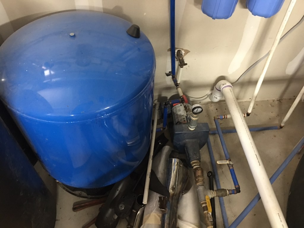

Rougarou Posted June 28, 2021 Author Share Posted June 28, 2021 On 12/14/2020 at 4:45 PM, ESokoloff said: Even the CPV systems require a tank (albeit minuscule in comparison) so you will still need to filter the water & keep tabs on the air pressure to get the longest life out of the tank. If you don’t have 3ph & not in need of a pump replacement, then that CPV sounds like the way to go. i don’t like the positioning of the tank in this example..... Too easy for debris to be trapped & impact the bladder. Top mounted would be the way to go if excepted. The little tank has no bladder and no air. Anyway, finally bought the kit, I hate plumbing. Wife and I sat most of yesterday figuring which parts we needed. Seems my line came into the house, then split to two spigots and traveled to the main water area, where it split again to go to other outside lines and the main house lines. After playing all day yesterday trying to figure out which connectors, piping and tools we needed (yes, needed a $70 Pex crimper, ugh), we go to the nearest Lowe's and get all this junk (I hate plumbing). Today was install day, all day cause I hate plumbing, and we had to make another trip to Lowe's due to some unforeseen issues with routing, also had to hit Home Depot too, 'cause Lowe's didn't have it all. After tightening some weeps (I hate plumbing), it seems to be functioning as it should. Time will tell if it does all that's needed,......did free up a wee bit of floor space due to getting rid of the busted bladder tank (30 gal),.....oh, and I hate plumbing. 1 Link to comment

ESokoloff Posted June 28, 2021 Share Posted June 28, 2021 17 hours ago, Rougarou said: The little tank has no bladder and no air. Got a manufacture & part#? I have to think this “little tank” has a compressible substance (albeit hermetically sealed). Link to comment
Rougarou Posted June 28, 2021 Author Share Posted June 28, 2021 3 hours ago, ESokoloff said: Got a manufacture & part#? I have to think this “little tank” has a compressible substance (albeit hermetically sealed). Nevermind, it does, but there's no schrader valve to do any adjustments, that's what led me to believe no air,....but I be wrong. Link to comment
ESokoloff Posted June 29, 2021 Share Posted June 29, 2021 1 hour ago, Rougarou said: Nevermind, it does, but there's no schrader valve to do any adjustments Look under the blue plastic cap (but DON’T ask me about Cobra cars). Link to comment
Rougarou Posted August 16, 2021 Author Share Posted August 16, 2021 Yep, there's a valve under the plastic cap. Since installing a couple of months ago, we ran it for a few days, but the output seemed a bit low. I upped the pressure a bit and then finally I cranked the pressure to 50/70 and all seems working as it should. When the water is turned on, the little tank depletes fairly quickly and the pressure valve drops, kicks the pump on and the pump stays on maintaining the desired pressure until water is turned off. Pump runs a wee bit more to fill the little tank and await its next use. I just wished I'da thunk the mounting options out a bit more to make the whole assembly (this kit, UV filter and particulate filter) a more compact assembly. Mebbe I'll waste a day and adjust all that,....but I really hate plumbing!! Link to comment
