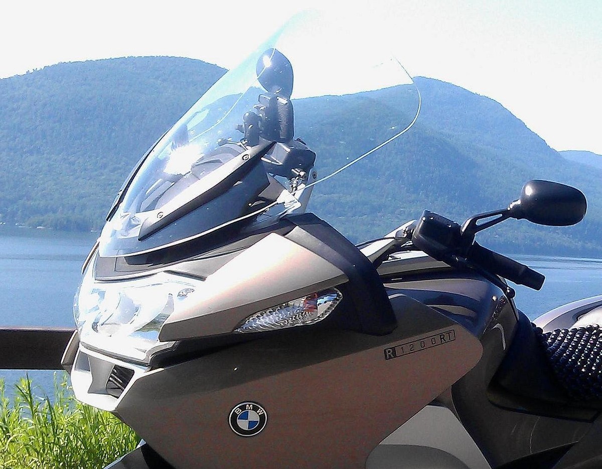

dirtrider Posted November 23, 2020 Posted November 23, 2020 3 hours ago, nateschisler said: What do you need to do to mount the K1200RS mirrors to an '09 R1200RT? Morning nateschisler Nothing special to just mount them as they bolt right on. If you have a wide windshield there might be contact at full lock but this isn't common. The biggest problem that I have seen is the K1200RS mirrors are not made for the 1200RT so the mirror heads don't quite move out far enough to see what you need to see behind you for some riders (I had to modify mine to allow the mirror heads to swing out a bit farther)

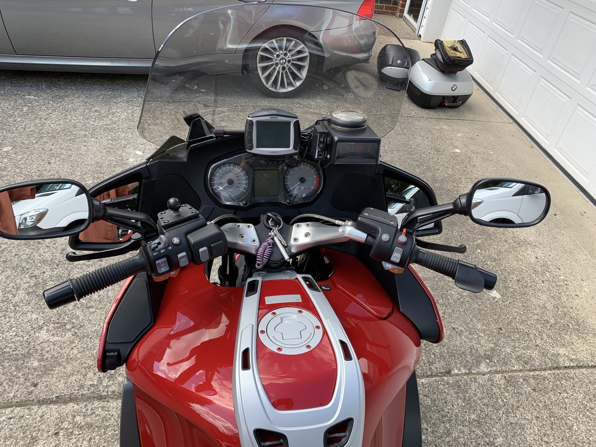

Dann Posted November 24, 2020 Posted November 24, 2020 Just an update. These mirrors cannot be installed on a R1250RT. (K1200RS) Fortunately for me, the stock mirrors on the Shiftcam are much better than the ones I had on my Hexhead
