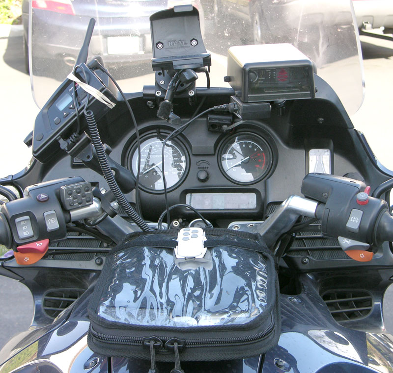

Gregori Posted April 24, 2006 Share Posted April 24, 2006 I've got a Chatterbox - which works reasonably well. FRS or GMRS versions are available, and as Fernando pointed out, they're built right in, so you don't have to worry about powering (or wiring) separate intercom and 2-way radio. It's powered by a built-in rechargeable battery, or you can get an adapter to power it from the bike electrical system. Mine is mounted to the handlebars, not my helmet. (Though I've had it on the helmet in the past.) I've got GPS, iPod, and Valentine1 plugged into it (via the Accessory Workshop audio mixer) and all three cut out when talking/receiving on the 2-way radio. LARGER version HERE (The rubber band is my low-budget 'strain relief' for the power cord, and headset extension.) Sound quality is decent, though certainly not stellar. Recently, I was told (by some riders with Autocom equipment) that my transmissions are sometimes pretty garbled. Although, that COULD be me mumbling into the mic as I try to avoid the hazard that I'm on the radio to warn them about. I will say that, except for occasionally weak volume, I could generally hear them clearly. When I use it with other Chatterbox users, however, I've always had good results. (Both transmit & receive.) What I like: Moderate entry price. The easy to adjust on-the-fly VOX and channel controls. The 2-way and aux inputs are not volume linked. The side-tone (you can hear yourself when you transmit) and the full duplex when using it as a rider-to-pillion intercom. (Meaning you can both talk at the same time, like you would on a telephone.) Customer service is pretty good: I lost a battery door, and they sent a new one out at no charge, even though the unit was several years old, and WAY out of warranty. I actually LIKE that it can be helmet mounted, as it allows use OFF the bike - at gas stops, or whatever. What I DON'T like: Funky shape - makes it hard to use off-helmet. Sound quality is not as nice as I'd like. Requires some kind of adapter to feed more than one audio source. (Has one Stereo Aux input. (As well as one Cellphone input, and a Push-to-Talk jack, neither of which I've ever used.) Battery life is only so-so, if used for 2-way a lot. (I get probably a solid 20 hours out of it, when just used as a way to pipe the GPS, radar and iPod sounds to the helmet, but when I'm riding and talking over it, I only get about 6-7 hours on a charge.) The Chatterbox is a viable (if budget) alternative. If I had to do it again I'd definitely consider the Autocom. I've heard very little negative about them, and they enjoy an excellent reputation here. (It's already been mentioned that the head honcho there is an regular contributor here, and offers exceptional troubleshooting expertise.) Hope this helps! G. Link to comment
KDeline Posted April 25, 2006 Share Posted April 25, 2006 Can you actually ride that bike? Link to comment
Gregori Posted April 25, 2006 Share Posted April 25, 2006 Can you actually ride that bike? Yep. It and I will be at Willow Springs next weekend. (I wonder if they'll ask me to take off the gadgets and my side cases?) Link to comment

Mike_Thompson Posted April 26, 2006 Author Share Posted April 26, 2006 Can you actually ride that bike? YOu might want to check out the postings for the guy out here that's looking for a solution for sunglasses. How much of a glare do you catch with all that hardware? Link to comment
