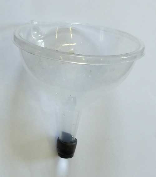

Phil50 Posted June 5, 2011 Author Share Posted June 5, 2011 First of all I'd just like to take the opportunity to thank all of you who have encouraged me to have a go at bleeding my brakes. It's the first time I've had the tank off and it is amazing how much you learn about your bike just be doing that simple procedure. Once you see with your own eyes where the alternator fits, and the Servo ABS etc etc are loads of other stuff you guys talk about starts to make sense. I've only done the front wheel circuits so far but it was so easy I wonder why I paid someone to do it for me all these years. The only gear I bought was a Vizibleed. Basically a bit of pipe with a none return valve on the end. I don't think you need one of these but it gives you confidence to take your time closing the bleed nipple once you have finished flushing through. On the picture guide in the bmwsporttouring.com FAQs it explains how to make a "mini Stan" with a special order part from your BMW dealer but in fact a 40p ASDA funnel with some self amalgamating rubber tape carefully screwed into the relevant orifice (as suggested by Andy Long and others) works perfectly. Thanks again, I'm off to do the rear and then the control circuits. Link to comment
