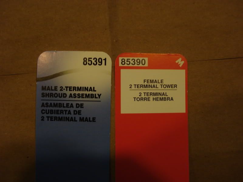

Semper_Fi Posted December 21, 2008 Share Posted December 21, 2008 "A weather proof two lead connector"??? Where do I obtain? what sounds (to me) like an exotic device. Joe I got it at my local auto parts store. Actually they carry 2, 3, 4 lead connectors. I bought a male/femal set up and soldered on accordingly. These are the parts: The only critical part of the job was to properly identify the positive wire once i took the connector apart. Link to comment
