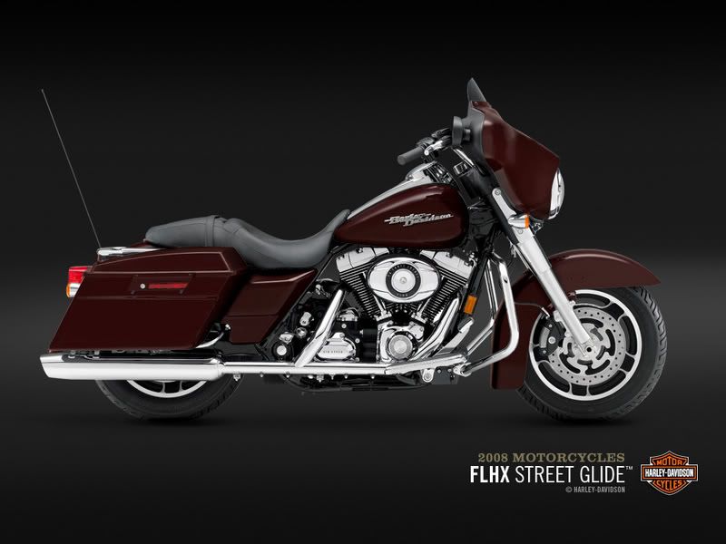

TEWKS Posted November 3, 2007 Share Posted November 3, 2007 What Harley did he buy? A friend of mine just bought one of these & he can't get the smile off his face. He said the power & handling is all you could ask for. His other bike is a CBR1100xx if that means anything. Pat Link to comment
