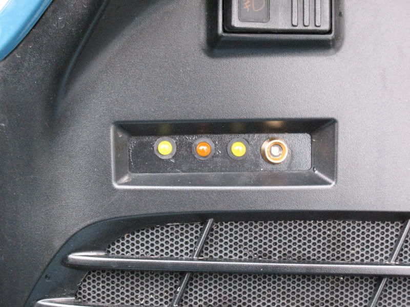

Sidmariner Posted April 5, 2007 Share Posted April 5, 2007 Radio Shack or any electrical supply outlet will have a variety of microswitches that you can squeeze into the slot. You will have to ensure the switch can handle the loads you want to run, as the smaller switches are generally designed for very low voltage. They can be kind of delicate too, as the posts are usually pretty thin. After I went down this road I decided not to use the slot for the actual switch, but to use if for the LEDs which are connected to my Autoswitch and auxiliary light switches which I mounted elsewhere. I also put the daylight sensor for my headlight modulator in the slot. For that it works perfectly. http://i41.photobucket.com/albums/e293/Margaree/IMG_02051.jpg Link to comment
