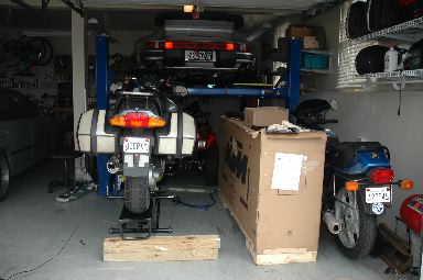

UberXY Posted March 24, 2007 Share Posted March 24, 2007 I bought a Kendon sport bike lift for an excellent price on eBay recently ($450) delivered, and while I am sure it's gonna be fine for my lightweight bikes (KTM and R65), I think my RT is just a little heavy for the it because of a simple design shortcut. Note in the attached photos thatI have to brace the rear extension. That is because without the brace the rear extension twists laterally a little. I think this is could be cured easily. The two brackets and pins that hold the extension on are in single shear; welding on an additional bracket on both sides and using a longer pin would put the extension in double shear, which is always a good fix for twisting under load. I am most likely gonna have a local welding shop do this for me. Link to comment
ShovelStrokeEd Posted March 24, 2007 Share Posted March 24, 2007 I would also be more than a little concerned about the narrow footprint of that lift. I can envision a bike toppling over if things got very high. Might want to investigate extending the feet outward by a foot or so on each side. If space in the garage is a concern, you could always telescope the tubing. Link to comment
