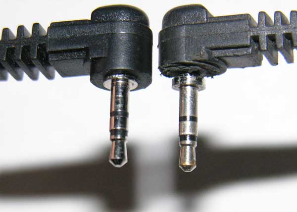

EffBee Posted February 22, 2007 Share Posted February 22, 2007 Often it's the hands-free socket on the cell that causes this problem. With many phones, this socket is not flush with the surface of the phone's plastic case. Instead, it is recessed so that the decorative rubber plug which covers the socket when not in use, can itself end up flush. Now, when you try and plug the Autocom lead into the socket, the plastic around the recessed socket doesn't allow the male pin to make full penetration and complete contact. The first thing I would do is check this. If necessary, grind down the black plastic around the top of the male pin on the Autocom cable in order to reduce its circumference and get it to fit into the plastic recess around the phone's hands-free socket. Once you're making full contact, your volume should increase. Link to comment
kenzst Posted February 22, 2007 Share Posted February 22, 2007 Fernando is right on the money. I trimmed mine down with an Exacto knife so the plug would go in all the way. Works fine. Link to comment
alanz Posted February 22, 2007 Share Posted February 22, 2007 I did the plug modification a year or so ago. I have some photos and notes if you click here. Link to comment
