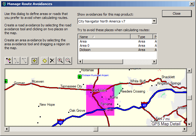

MattS Posted February 17, 2007 Share Posted February 17, 2007 Edit:Preferences:Routing:Try to Avoid:Advanced Gives you a window where you can declare areas to be avoided. Link to comment
marcopolo Posted February 18, 2007 Share Posted February 18, 2007 ...and after you create that route avoidance make sure you: 1) click on "apply" in the routing dialogue box; and, 2) go back into your original route and "recalculate" it. Link to comment
