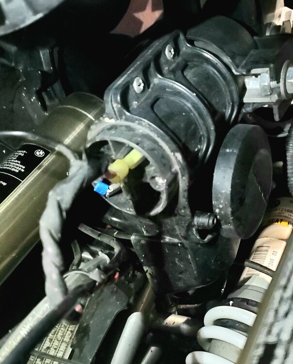

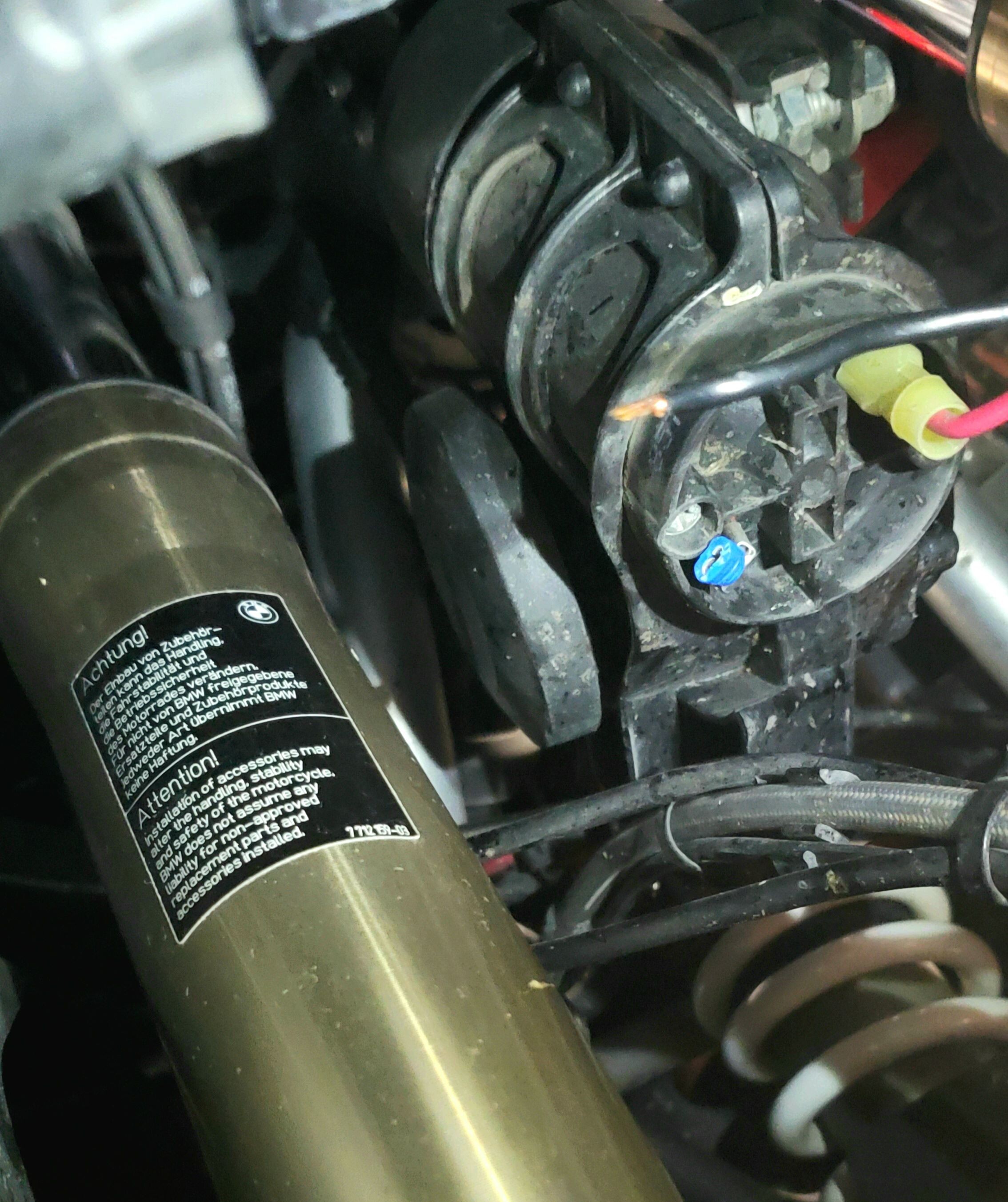

Colorado Jeff Posted December 1, 2021 Share Posted December 1, 2021 Hi All: I bought a 2018 R1200RT about a year ago and it came with a SoundBomb installed. All was well, and we really love the big attention grabbing sound. But in the last six months, nearly every time we ride, the black wire would get cut right at the connection. At the 12k last summer, the service guy let me know it was cut. That was only the second time, so I was surprised. He made a statement about a SoundBomb and how a wethead needs the compact version. I stated that I thought it was the compact version. He went into the shop to look and never came back and corrected me, so I assumed it was a compact. Since that time, the wire has been cut and the connecter smashed on nearly every ride. Looking at the images, is it the "Denali SoundBomb Compact Dual-tone Air-horn" or not? Looks like one in the pictures on the Denali site to me, but it wouldn't be the first time I was wrong... today. If it is the compact, why is the wire being cut, but more importantly, how do I fix it? Link to comment
MachineJoe Posted December 1, 2021 Share Posted December 1, 2021 Jeff, Looks like my Denali mini/compact. To me it doesn't look like it was cut or even smashed. Is it being pulled out by not having enough slack when you go full left or right? 1 Link to comment
Rougarou Posted December 1, 2021 Share Posted December 1, 2021 Yep, looks pulled, give it some more slack and see what happens. Link to comment
Colorado Jeff Posted December 1, 2021 Author Share Posted December 1, 2021 Thanks guys for the thoughts, there is plenty of slack in the wire (for now anyways, a little gets eaten every time I have to fix it) and the connecter is definitely being smashed. I just pulled the connector out of the bottom of the SoundBomb and like all the other times, it's been smashed over and the wire cut. The service guy at BMW of Denver said something about suspension banging on the SoundBombs, which is why one needs the compact version. I do have the compact, but am still having this issue. 1 Link to comment
Rougarou Posted December 1, 2021 Share Posted December 1, 2021 Better crimping, then heatshrink around the connector/crimped part Link to comment
Colorado Jeff Posted December 1, 2021 Author Share Posted December 1, 2021 21 minutes ago, Rougarou said: Better crimping, then heatshrink around the connector/crimped part Thank you for the advice, but not sure how this will resolve the issue. This does not appear to be an issue of making a better, more secure and waterproof connection. The horn works fine when I fix it. The crimped connector went on to the SoundBomb straight, and when I check after losing the horn, the connector is bent over like you see in the picture. Something is hitting the connector, just like the service guy suggested. So why now and not in the first six months of owning using the bike? Why my compact SoundBomb but not yours? Mine appears to be installed correctly with the correct Denali mounting bracket. Link to comment
Rougarou Posted December 1, 2021 Share Posted December 1, 2021 Could be a hit or could be a pull. Either way, looking at the copper wire in the first happy snap, the wire "appears" flat, as if it was pulled out and not cut. Pulling can and do bend the connectors. Quadruple check that there's enough slack in the line, stop to stop, bounce to bounce and stop/bounce to stop/bounce.........I dunno. 1 Link to comment

Colorado Jeff Posted December 2, 2021 Author Share Posted December 2, 2021 19 hours ago, Rougarou said: Could be a hit or could be a pull. Either way, looking at the copper wire in the first happy snap, the wire "appears" flat, as if it was pulled out and not cut. Pulling can and do bend the connectors. Quadruple check that there's enough slack in the line, stop to stop, bounce to bounce and stop/bounce to stop/bounce.........I dunno. Thank you again for the suggestions, there's plenty of slack in the wires. It does not pull when I go lock-to-lock on the handlebars. The horn worked fine for the first six months I owned the motorcycle with no issues whatsoever. In addition, the red wire had never been damaged or pulled out. If the wire was short for the black wire, it'd also be too short for the red wire. Link to comment

Colorado Jeff Posted December 8, 2021 Author Share Posted December 8, 2021 Update: I fixed the wire connector and the horn worked fine before we left for a Saturday ride. I ensured that I had plenty of slack in the wires and checked to make sure there was no interference when moving the handlebars from lock-to-lock. I saw no other item that might interfere with the wires Not even 20 miles down the road on a very relaxing ride (i.e. no aggressive riding of any kind; no fast acceleration, no quick stops, no high-lean corners) and the wire was already disconnected from the horn. The connector is once again bent over to the left, the wire itself was not cut. It's odd that the red power wire is not impacted. The picture below was taken at our lunch stop 50 miles after I noticed the horn was not functioning. This is baffling. 1 Link to comment
dirtrider Posted December 8, 2021 Share Posted December 8, 2021 14 minutes ago, Colorado Jeff said: Update: I fixed the wire connector and the horn worked fine before we left for a Saturday ride. I ensured that I had plenty of slack in the wires and checked to make sure there was no interference when moving the handlebars from lock-to-lock. I saw no other item that might interfere with the wires Not even 20 miles down the road on a very relaxing ride (i.e. no aggressive riding of any kind; no fast acceleration, no quick stops, no high-lean corners) and the wire was already disconnected from the horn. The connector is once again bent over to the left, the wire itself was not cut. It's odd that the red power wire is not impacted. The picture below was taken at our lunch stop 50 miles after I noticed the horn was not functioning. This is baffling. Afternoon Colorado Jeff You might have to move that horn to another location, when you hit a big bump, or stop hard, the front suspension compresses allowing something on the front lower fork cross-brace, control arm, or fender to come up & contact those horn connections. (look for witness marks to see what is possibly hitting that horn) Link to comment
Rougarou Posted December 8, 2021 Share Posted December 8, 2021 Even under slightest compaction, that brake line bundle looks like will rise up and as you push right, it looks like it will compact into the black wire and snag the wire on the bundle holder pulling it out. Try routing the horn wires from the "up" side and either pre-bending your connector or getting a bent connector. Or, move the horn Link to comment

Colorado Jeff Posted December 8, 2021 Author Share Posted December 8, 2021 2 hours ago, Rougarou said: Even under slightest compaction, that brake line bundle looks like will rise up and as you push right, it looks like it will compact into the black wire and snag the wire on the bundle holder pulling it out. Try routing the horn wires from the "up" side and either pre-bending your connector or getting a bent connector. Or, move the horn Excellent thought on the brake line bundle, I'll see about moving it. As for moving the horn, that is an option too. However, this is using a Denali mount specific for this motorcycle and others who have this same horn are not having the same issue. THAT, and why only in the last six months of riding and NOT the first six months of owning the motorcycle is what is baffling the most to me. Link to comment

Colorado Jeff Posted December 8, 2021 Author Share Posted December 8, 2021 3 hours ago, dirtrider said: Afternoon Colorado Jeff You might have to move that horn to another location, when you hit a big bump, or stop hard, the front suspension compresses allowing something on the front lower fork cross-brace, control arm, or fender to come up & contact those horn connections. (look for witness marks to see what is possibly hitting that horn) Thanks for the suggestion, I'll be looking at moving if I cannot figure out another solution. Link to comment
dirtrider Posted December 9, 2021 Share Posted December 9, 2021 12 hours ago, Colorado Jeff said: I'd really like to see what the heck is going on here. I'm going to look into that this weekend. Morning Jeff Just straighten that bent horn terminal out to be straight as when first installed, then cut 3 Q-tips in half (shorten them), then firmly tape those 3 shortened Q-tips to the wire connector (no wire in it). Next, put the connector back on the horn terminal, then put a glob of bright lipstick on those 3 Q-tips that stick down. Then go ride the motorcycle. After the ride look for the lipstick marking (witness marks) on whatever is coming up & contracting the Q-tips. 2 Link to comment
Colorado Jeff Posted December 9, 2021 Author Share Posted December 9, 2021 1 hour ago, dirtrider said: Morning Jeff Just straighten that bent horn terminal out to be straight as when first installed, then cut 3 Q-tips in half (shorten them), then firmly tape those 3 shortened Q-tips to the wire connector (no wire in it). Next, put the connector back on the horn terminal, then put a glob of bright lipstick on those 3 Q-tips that stick down. Then go ride the motorcycle. After the ride look for the lipstick marking (witness marks) on whatever is coming up & contracting the Q-tips. That's a fine idea. We were trying to think of a good way to leave a mark, and I think you nailed it with lipstick. Jeff Link to comment

Lowndes Posted December 14, 2021 Share Posted December 14, 2021 It looks like you might not be getting a good crimp on that connector. Do you use a good crimper tool?? Pliars won't do it. The end of the wire that pulled out (its fuzzy, out of focus a little) should show definite deformation and the crimp should be in a "U" shape. The flag connector that Ikraus suggested would get the wire going in the direction it needs to go. Link to comment
Rougarou Posted December 14, 2021 Share Posted December 14, 2021 Ya, but that doesn't explain the bending of the connector Link to comment
Lowndes Posted December 14, 2021 Share Posted December 14, 2021 33 minutes ago, Rougarou said: Ya, but that doesn't explain the bending of the connector Correct, but if it gets the wires out of the way of whatever is bending them... I like the lipstick on the camera idea. Link to comment
Paul De Posted December 15, 2021 Share Posted December 15, 2021 I would have thought the hard blue insulator on the connector would have left a scuff or mark on what ever was smacking into the connector hard enough to bend it. Great use of lipstick, it is almost as handy as duct tape. When the wife was pitching a tube of lipstick because she didn't like the shade anymore, I snagged it out of the trash for the tool box. I got the what are wanting that for look, so I told her I was getting in touch with my feminine side... Seriously though, every tool box should have a tube of lip stick. Last time I used it was when I installed some wood paneling and outlined the edge of a switch box with it on the back of the panel. You will get a perfectly sized and placed cut out every time! I may have missed it, so I hope this isn't a redundant. If you haven't repaired it yet, use a 90 degree connector for this fix. Also a couple of short pieces of shrink tube as a flex/stress relief where the wire is crimped to the connector. I have used two layers of shrink tube where the wire was likely two be flexed at the connection point. The first layer of shrink tube goes on the wire itself and a second layer of shrink tube that covers the shank of the connector and first layer of shrink tube. 1 Link to comment
Colorado Jeff Posted December 16, 2021 Author Share Posted December 16, 2021 On 12/15/2021 at 10:04 AM, Paul De said: I would have thought the hard blue insulator on the connector would have left a scuff or mark on what ever was smacking into the connector hard enough to bend it. Great use of lipstick, it is almost as handy as duct tape. When the wife was pitching a tube of lipstick because she didn't like the shade anymore, I snagged it out of the trash for the tool box. I got the what are wanting that for look, so I told her I was getting in touch with my feminine side... Seriously though, every tool box should have a tube of lip stick. Last time I used it was when I installed some wood paneling and outlined the edge of a switch box with it on the back of the panel. You will get a perfectly sized and placed cut out every time! I may have missed it, so I hope this isn't a redundant. If you haven't repaired it yet, use a 90 degree connector for this fix. Also a couple of short pieces of shrink tube as a flex/stress relief where the wire is crimped to the connector. I have used two layers of shrink tube where the wire was likely two be flexed at the connection point. The first layer of shrink tube goes on the wire itself and a second layer of shrink tube that covers the shank of the connector and first layer of shrink tube. Thanks Paul, great ideas! I appreciate it. Link to comment
Colorado Jeff Posted December 16, 2021 Author Share Posted December 16, 2021 On 12/14/2021 at 4:53 AM, Lowndes said: It looks like you might not be getting a good crimp on that connector. Do you use a good crimper tool?? Pliars won't do it. The end of the wire that pulled out (its fuzzy, out of focus a little) should show definite deformation and the crimp should be in a "U" shape. The flag connector that Ikraus suggested would get the wire going in the direction it needs to go. Thank you Lowndes, I am using a nice new crimper tool, very similar to what you showed in the picture. Agreed, will use a 90 degree connector next. 1 Link to comment
