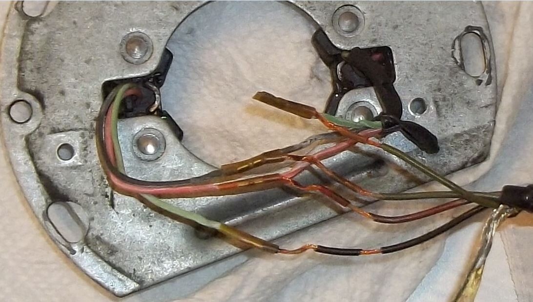

Lowndes Posted October 20, 2021 Share Posted October 20, 2021 Dimlout - here are the pics of the HES rewire on my '99 R1100RT, before and after GSAddict (Reto Camenisch; arbcon@sunshinecoast.ca) did the rewire, complete with a new connector: The 5 small wires are inside a larger soft sheath. The wires are only exposed on the end at the connector. The connector is inside a once soft plastic "bell" shaped cover that was hard as a bowling ball in 2017 when all this happened. The connector/cover is under the fuel tank and a pain to get to. I had to cut the off the cover to disconnect it. If you have a white sheath or the wires at the connector are in perfect condition then it has been replaced already. If you or a PO hasen't yet, you might want to replace the plastic fuel line disconnect with brass (the plastic gets brittle with age, will break and dump fuel on you and the engine. https://www.beemerboneyard.com/cpcqkdiscon.html This would be the perfect time to take care of that if it hasn't been done already. BEFORE you remove the HES backing plate from the engine, scribe a line (below) from the plate to the engine as an index mark so you can replace it in the same position/orientation after the rewire. All my pics are here: https://goo.gl/photos/xriJRtXqd1mHDmZ78 Hope this helps!! 1 Link to comment
